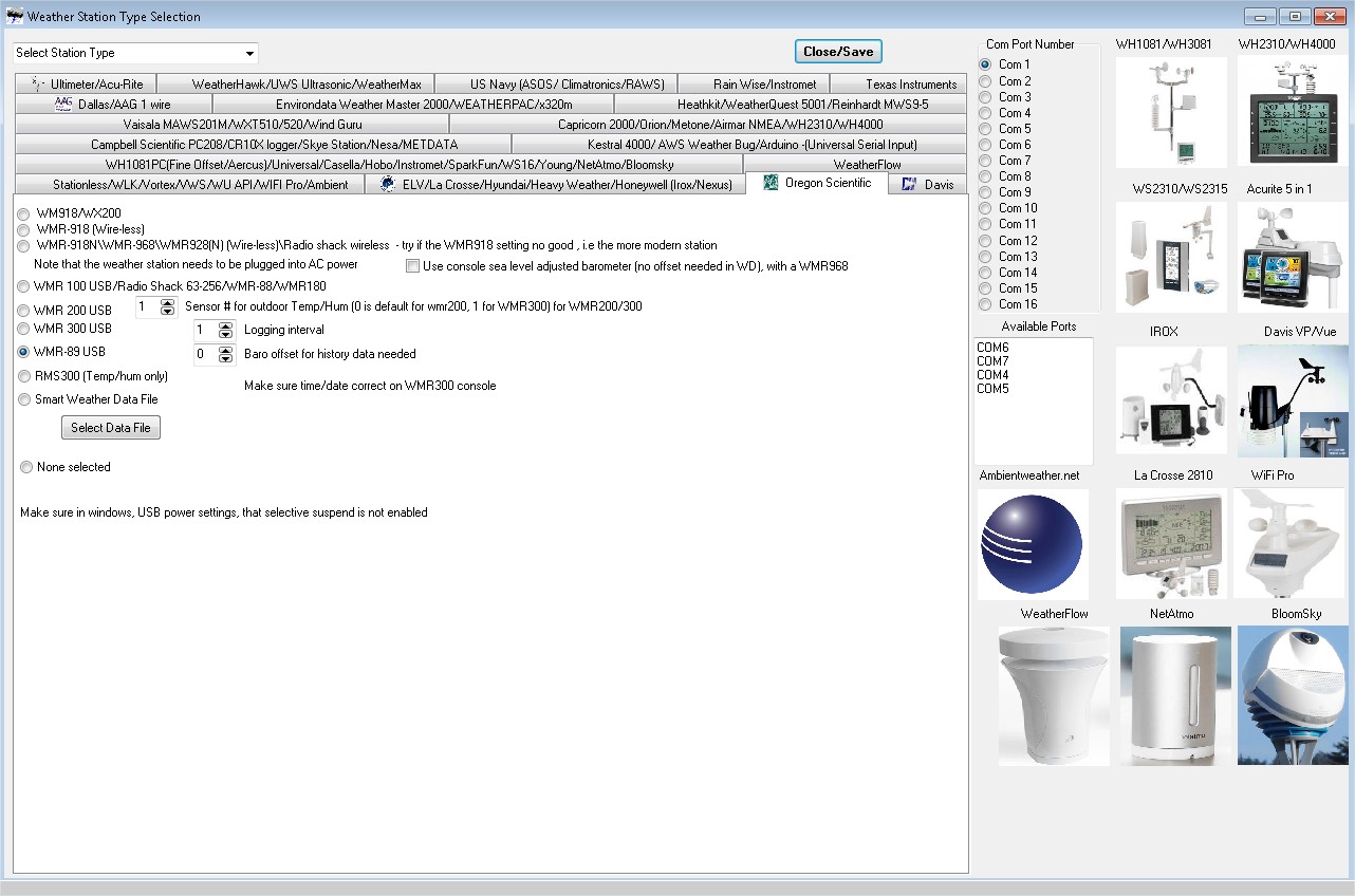

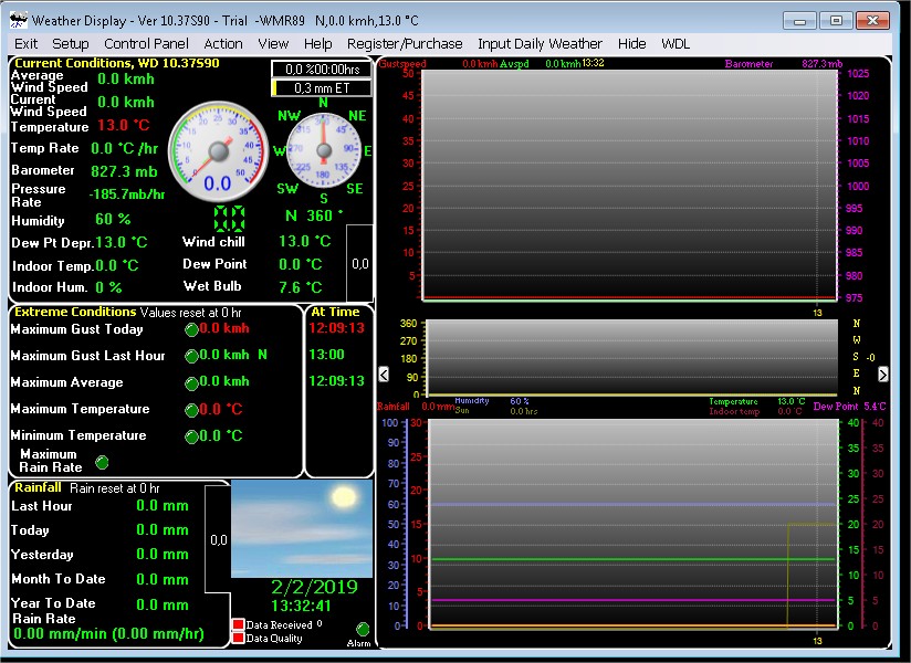

I have a WMR89 with UV sensor, and after some search I opted for Weather Display.
I have everything configured and connected on the station screen, but I'm having some problems with this software.
I'm also using the WeatherDisplay test version that have the download link a few posts above.
This is what I have in the main screen of WD:
And this is the configured station on the WD:
There is no wind values and the Data from the station its red.
What I'm doing wrong?

What is the barometric pressure showing on the WMR89?
Offline tete
  • Posts: 8
  • OS/Browser:
  • Win NT 10.0
  • Firefox 64.0
Re: WMR89
« Reply #13 on: February 02, 2019, 03:50:47 PM »
At this moment is 1016mb
« Last Edit: February 02, 2019, 04:22:15 PM by tete »
Offline Weather Display
  • Posts: 85,948
  • Davis VP2
  • New Zealand
  • OS/Browser:
  • Win NT 10.0
  • Chrome 71.0.3578.98
    • Weather Display
Re: WMR89
« Reply #14 on: February 02, 2019, 05:45:20 PM »
is there a com port showing up in windows device manager?
(i.e to then be able to select in WD)
you might need to first install the software that comes with the station to get the com port driver installed
what shows in WD under view,debug info?
the low barometer reading showing in WD might be a clue...have you set any barometer offset in WD?
