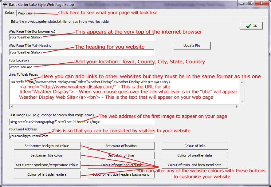

c. You will now see the "Basic Carter Lake Style Web Page Setup" window (fig3).
Follow the notes below and then click on the "Update File" button when complete. Now you can click on the "Web View" tab at the top of the screen to see what it looks like.
Note: If you make any changes, you must click the "Update File" button before the changes will show in the Web View.
fig3
