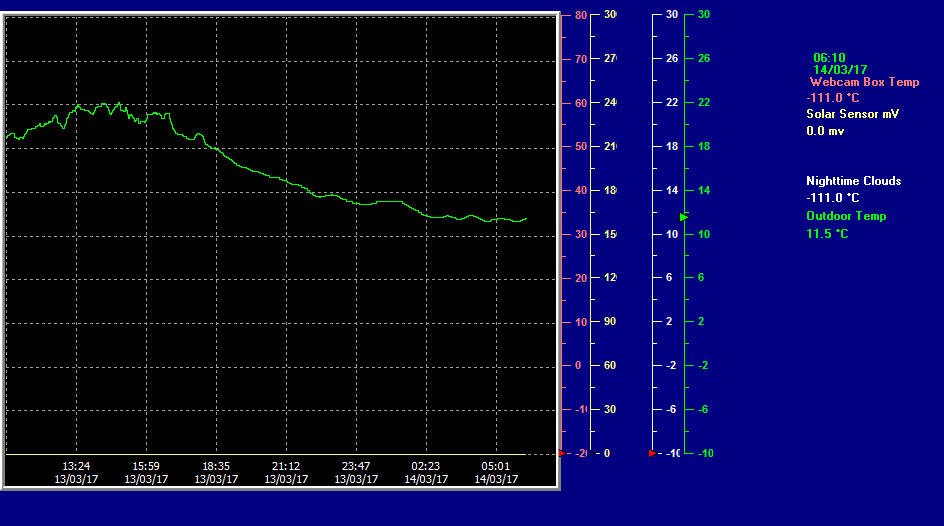

The camera is quite "weighty" and solid.  I am mounting mine in an electrical Junction Box - moulded fibreglass style with a clear ABS front panel.  I will also fit a PC PS fan at 7.5vdc and three resistors at 20V for 20W heating/demisting as I have done before for my externally roof mounted logitech.  You can see the effect of the heating circuit on this image - the red line and has 10degC bumps over a three hour period at morning and evening. There is also an ambient temp cold switch in series with the timer - if ambient is hot it won't come on.
http://inmanavenue.com/extrarealtimegraph.gif
Later I hope to have a pan and possibly tilt operation and drive the whole box around, so I need it large enough for bits inside and small enough to use servo motor drives to aim it.  Also the cables both attach to the camera at the same port side door (6.5vdc supply and the small USB cable).  Hopefully it is 8" wide x 6" high and 4" deep, ie 200 x 150 x 100mm.
