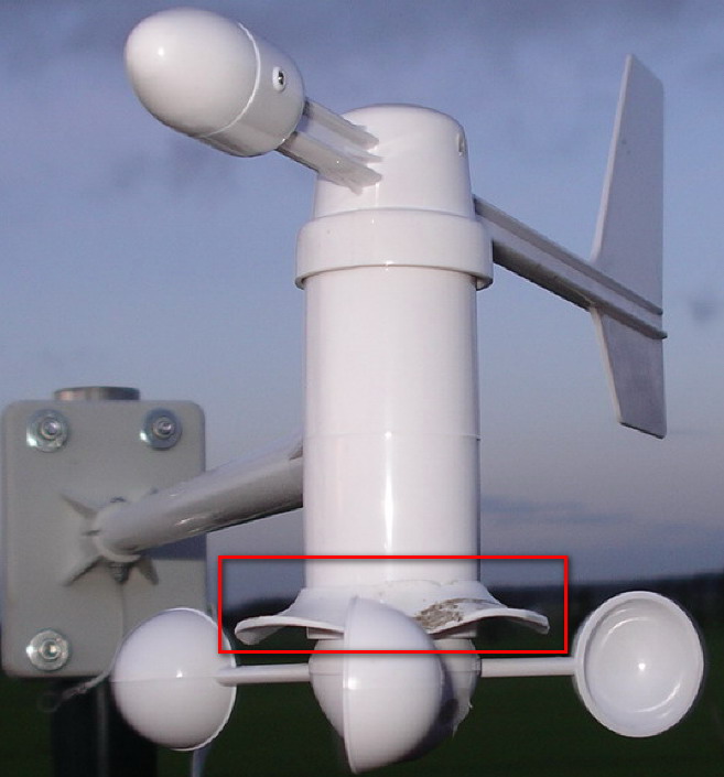

Re: WMR968 Anemometer Freezing and Paint....
« Reply #10 on: January 18, 2007, 04:12:19 PM »
Here is a easy fix for frozen vind vanes/anemometers:  :D OS, Lacrosse and others.
I used the bottom of a soft plastic bottle and cut a hole in it and pushed in on the anemometer.
When time and weather allows i will take it down and make a new one that looks/fits better  :oops:
It works fine like this, it's just ugly to look at  :roll:
 :) Krister
Offline Weather Display
  • Posts: 64,498
« Reply #11 on: January 18, 2007, 09:29:54 PM »
thats the idea....a skirt  :wink:
(which a davis station has)
